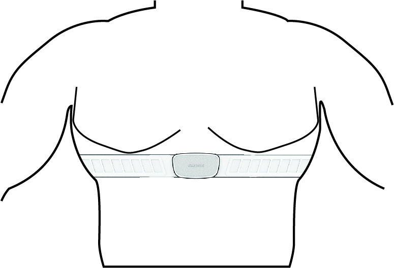

You should wear the heart rate monitor directly on your skin, just below your sternum. It should be snug enough to stay in place during your activity.

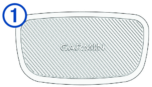

- Snap the heart rate monitor module
onto the strap.
The Garmin logos on the module and the strap should be right-side up.

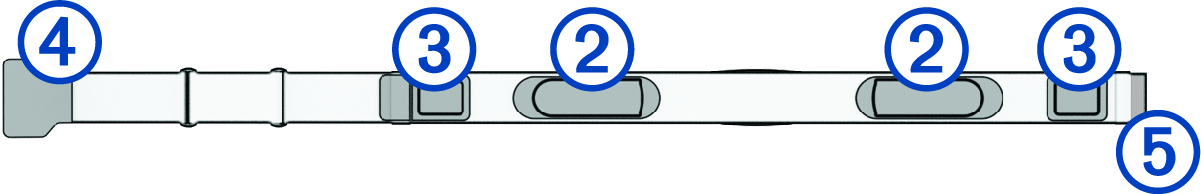

- Wet the electrodes
and the contact patches
on the back of the strap to create a strong connection between your chest and the transmitter.
- Wrap the strap around your chest, and connect the strap hook
to the loop
NOTE: The care tag should not fold over.
The Garmin logos should be right-side up.
- Bring the device within 3 m (10 ft.) of heart rate monitor.
After you put on the heart rate monitor, it is active and sending data.
