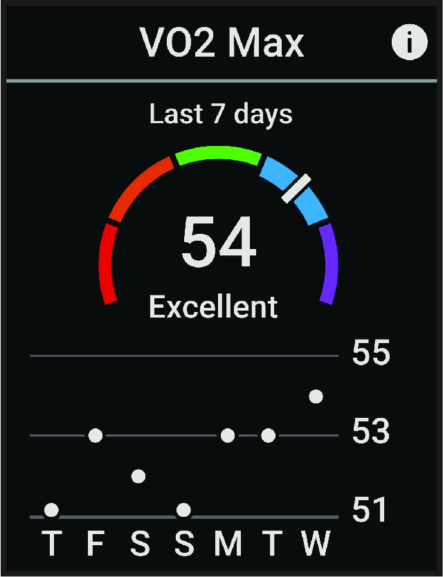

Your VO2 max. estimate appears as a number and position on the color gauge.
Purple |
Superior |
Blue |
Excellent |
Green |
Good |
Orange |
Fair |
Red |
Poor |
