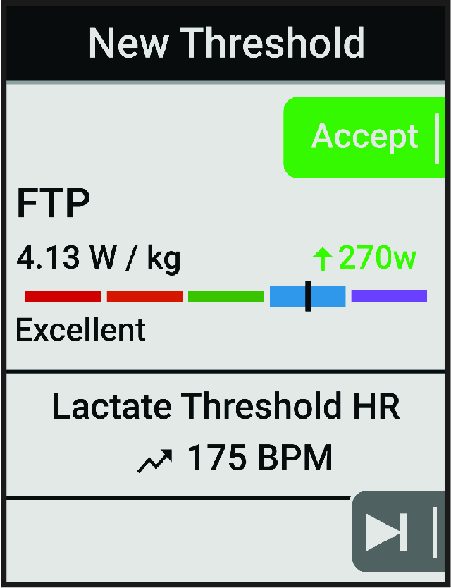

Getting Your FTP Estimate
The device uses your user profile information from the initial setup to estimate your functional threshold power (FTP). For a more accurate FTP value, you can conduct an FTP test using a paired power meter and heart rate monitor (Conducting an FTP Test).
Select
> My Stats > Power > FTP.
Your FTP estimate appears as a value measured in watts per kilogram, your power output in watts, and a position on the color gauge.
Purple |

For more information, see the appendix (FTP Ratings).

After you begin your ride, the device displays each step of the test, the target, and current power data. A message appears when the test is complete.
- Press
to stop the activity timer. - Select Save.
Your FTP appears as a value measured in watts per kilogram, your power output in watts, and a position on the color gauge.
