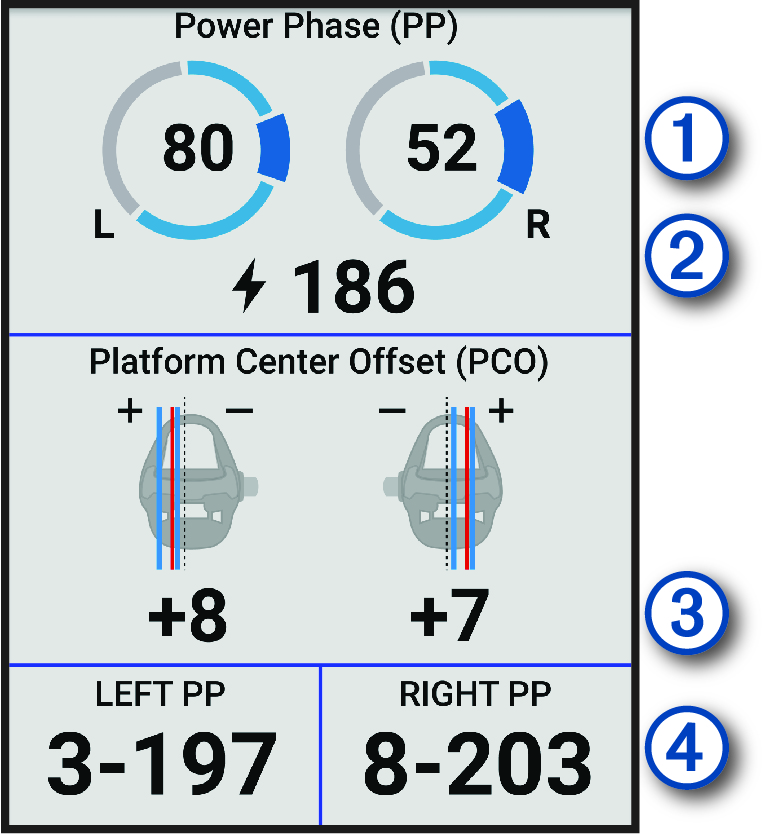

  2. Scroll to the cycling dynamics screen to view your power phase data , total power , and platform center offset .
  1. If necessary, hold a data field to change it (Adding a Data Screen).
NOTE: The two data fields at the bottom of the screen can be customized.
You can send the ride to the Garmin Connect app to view additional cycling dynamics data (Sending Your Ride to Garmin Connect).
Power Phase Data
Power phase is the pedal stroke region (between the start crank angle and the end crank angle) where you produce positive power.
Platform Center Offset
Platform center offset is the location on the pedal platform where you apply force.
