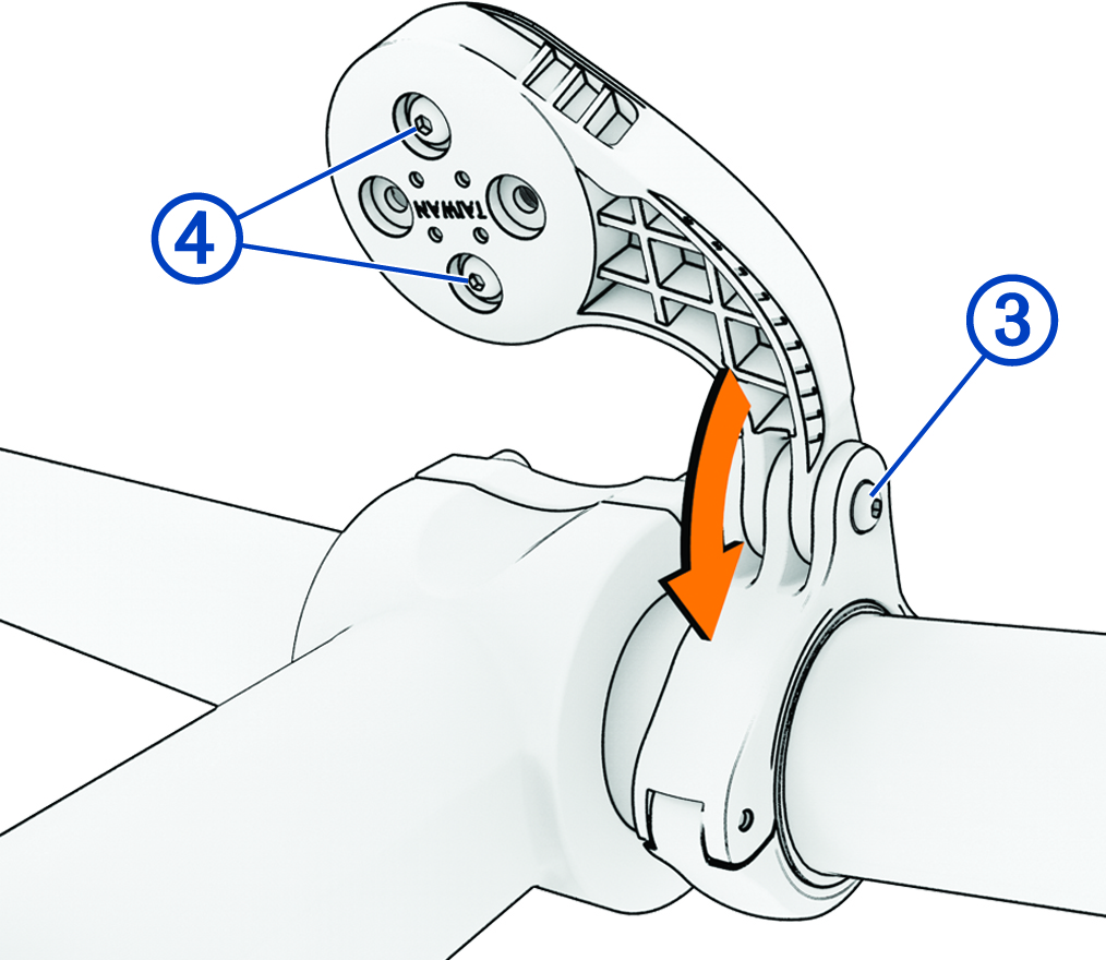

- Place the handlebar connector around the handlebar, so that the mount arm is above the bike stem.
- Use the 3 mm hex key to loosen the screw
on the mount arm, position the mount arm, and tighten the screw.
NOTE: Garmin recommends tightening the screw so the mount arm is secure, with a maximum torque specification of 20 lbf-in. (2.26 N-m). You should check the tightness screw periodically.
- If necessary, use the 2 mm hex key to remove the two screws on the back side of the mount
, remove and rotate the connector, and replace the screws to change the orientation of the mount. - Replace and tighten the screw on the handlebar connector.
NOTE: Garmin recommends tightening the screw so the mount is secure, with a maximum torque specification of 7 lbf-in. (0.8 N-m). You should check the tightness screw periodically.
