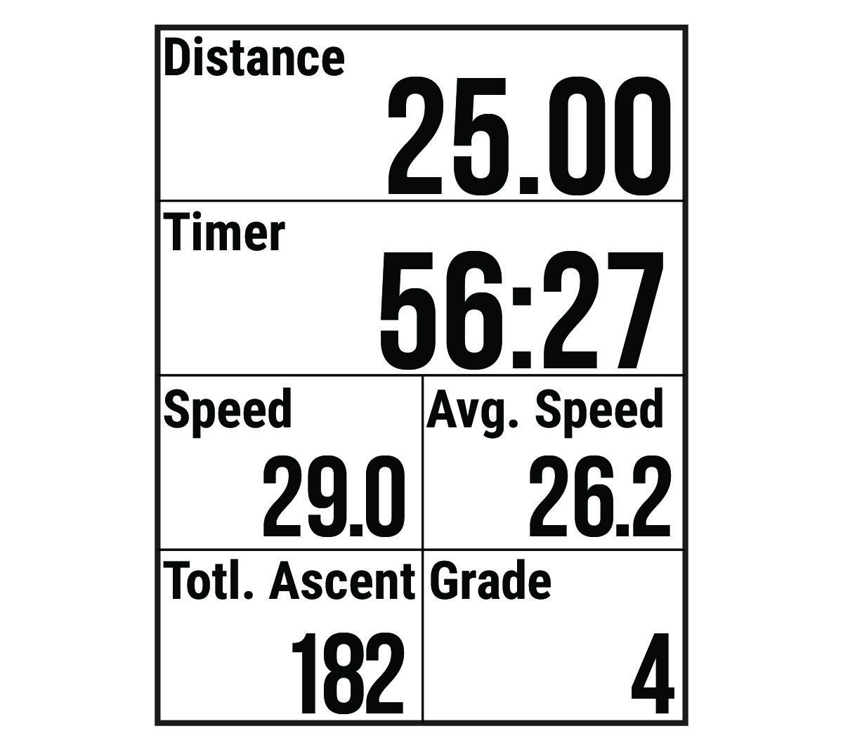

  2. Go outside, and wait while the device locates satellites. appears solid when the device is ready.
  3. From the home screen, select .
  4. Select the ride type.
    TIP: Accurate ride type data is important for creating bike friendly courses on your Garmin Connect account.
  5. Select to start the activity timer.
    NOTE: History is recorded only while the activity timer is running.
