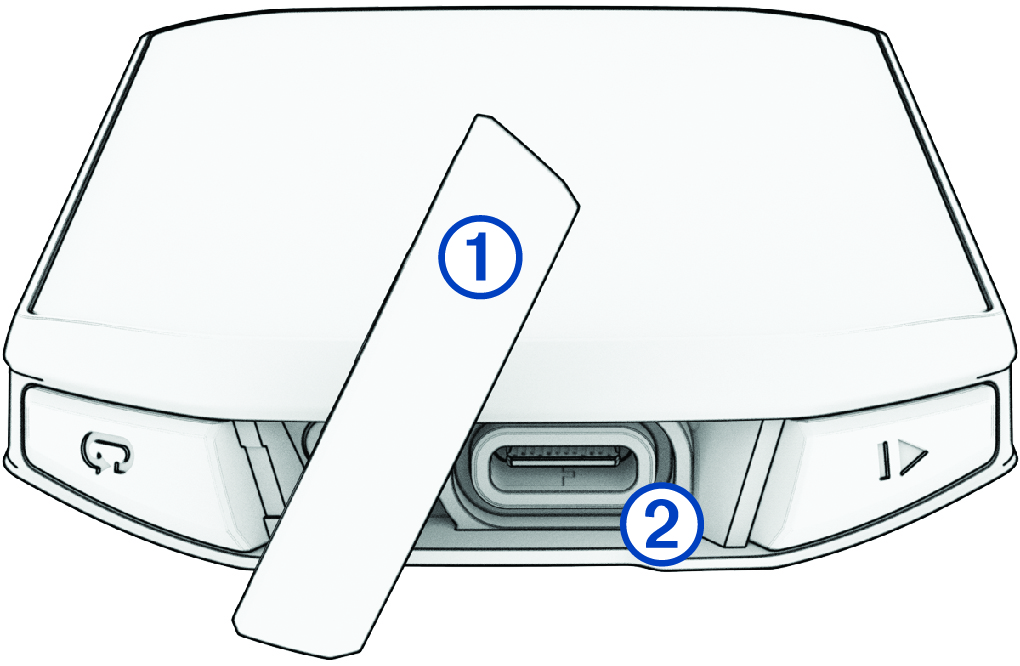

Charging the Device
NOTICE
To prevent corrosion, thoroughly dry the USB port, the weather cap, and the surrounding area before charging or connecting to a computer.
To prevent short circuits, remove any dirt, dust or debris from the USB port and the connector before charging the device.
NOTE: The device will not charge when outside the approved temperature range ().
  1. Pull up the weather cap from the USB port .
  1. Plug the cable into the charging port on the device.
  2. Plug the other end of the cable into a USB charging port.
When you connect the device to a power source, the device turns on.
  1. Charge the device completely.
After you charge the device, close the weather cap.
