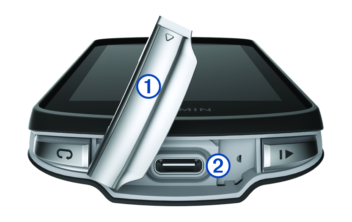

  1. Pull up the weather cap from the USB port .
  1. Plug the small end of the USB cable into the USB port on the device.
