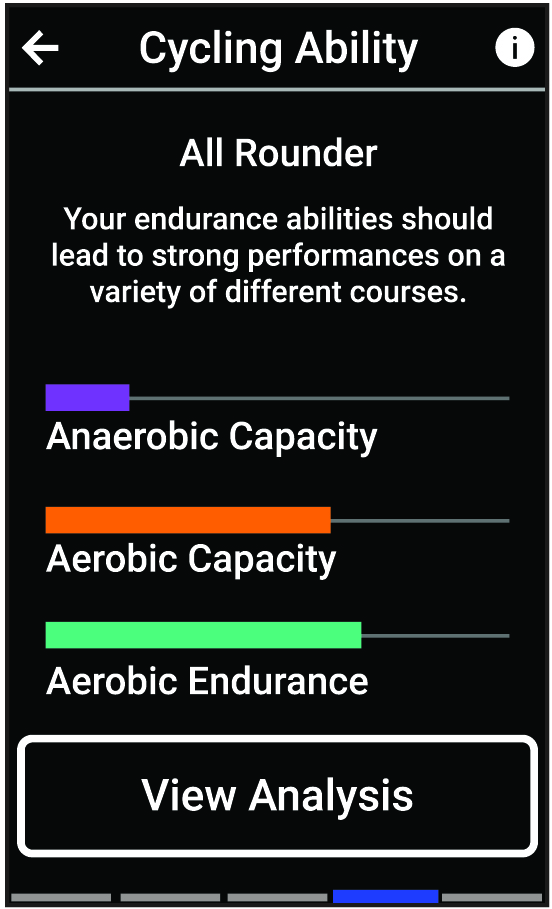

Cycling ability is a measurement of your performance across three categories: aerobic endurance, aerobic capacity, and anaerobic capacity. Cycling ability includes your current rider type, such as climber. Information you enter in your user profile, such as body weight, also helps determine your rider type (Setting Up Your User Profile).
  1. From the home screen, swipe to view the cycling ability glance.
NOTE: You may need to add the glance to your home screen (Viewing Glances).
  1. Select the cycling ability glance to view your current rider type.
  1. Select View Analysis to view a detailed analysis of your cycling ability (optional).
