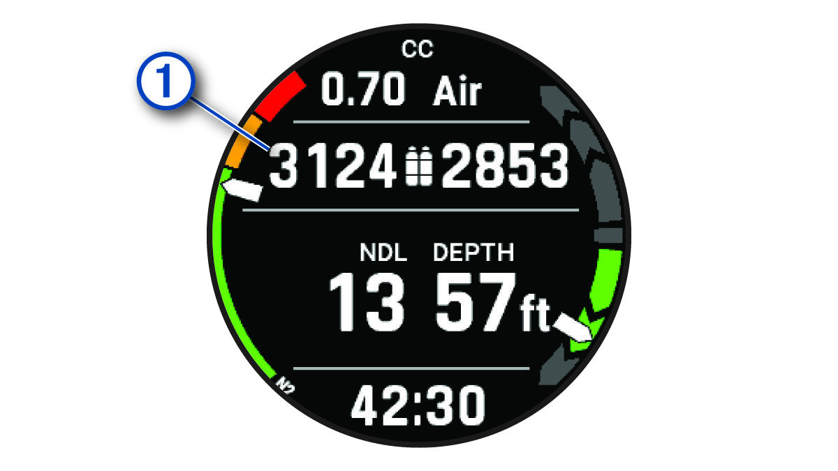

  3. Press START until the primary dive data screen appears.
    The primary dive data screen displays up to two paired transmitters (Selecting Paired Transmitters to View on Your Dive Data Screens).
    NOTE: You can use this screen to confirm your paired transmitters are connected to your dive computer prior to starting your dive.
