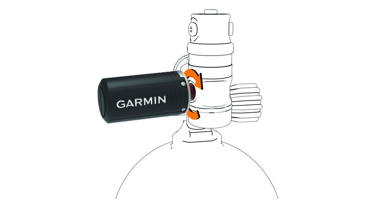

The transmitter connects to a high pressure output port of the first-stage regulator.
  1. Confirm the regulator is depressurized and detached from a scuba cylinder.
  2. Remove the port plug from the high pressure output port of the first-stage regulator.
  3. Confirm the flow restrictor is installed in the transmitter.
  4. Screw the transmitter onto the high pressure output port until you feel resistance.

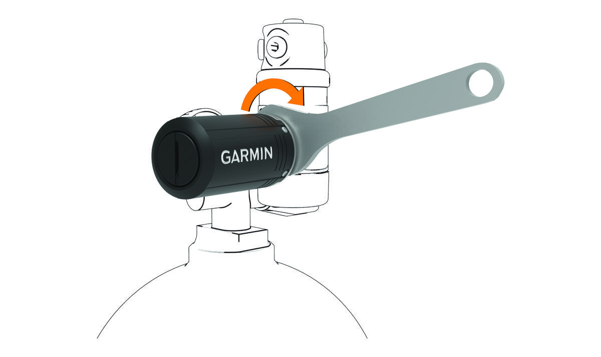

    WARNING
    Verify the installed transmitter does not physically interfere with any hoses or other tank assemblies.
  5. Use a 5/8 in. (16 mm) wrench to tighten the transmitter.
NOTICE
To prevent damage to the transmitter and possible loss of function, do not overtighten. Do not use the transmitter housing to tighten or loosen the transmitter.Do not grip the regulator or the transmitter to move, carry, or adjust the tank.
