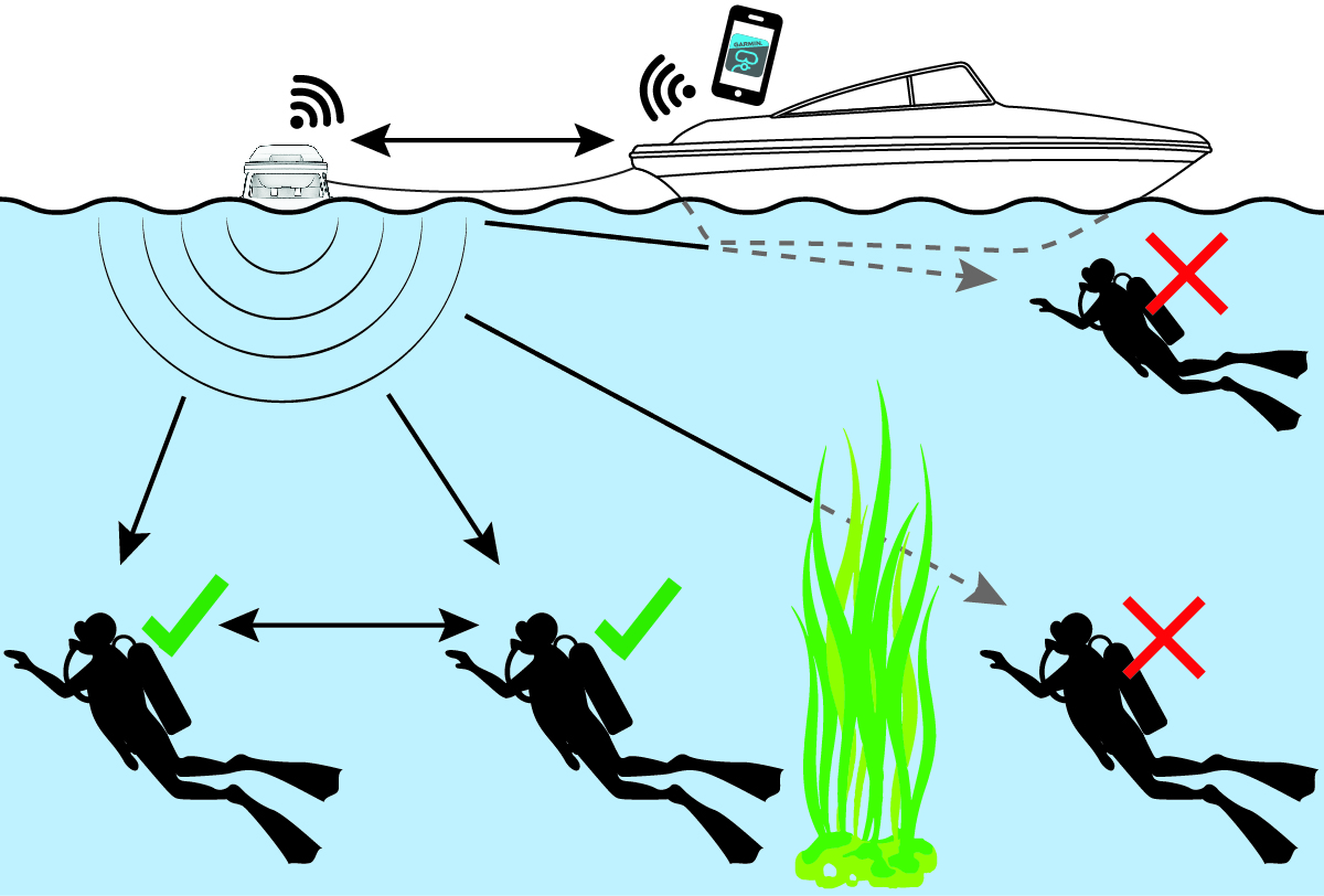

  • For best results and to maximize connectivity, position the buoy within 60 m (197 ft.) of surface support and in the direction of the dive site.
  • Make sure that the buoy has a clear line of sight to the divers below the surface. Any obstructions, such as the boat hull or underwater objects, can interfere with sending and receiving data.
