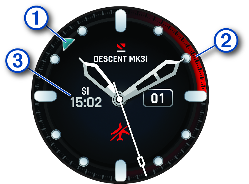

Default Watch Face
Alternate time zone pointer. References the 24-hour time markings on the watch (Adding Alternate Time Zones).
No-fly time remaining. References the 24-hour time markings on the watch (No-Fly Time).
Surface interval (SI) time after a dive (Viewing the Surface Interval Glance).
