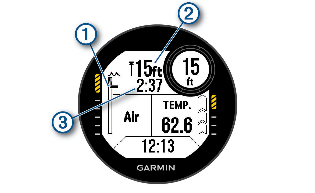

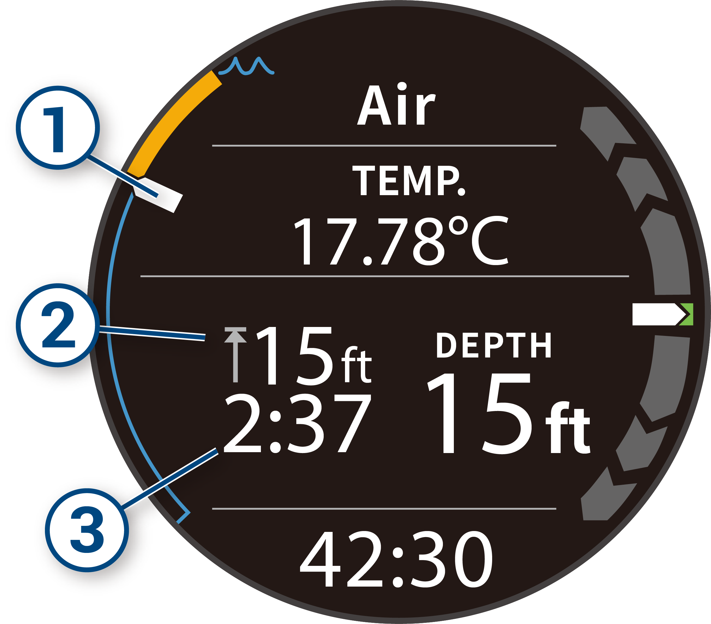

    Safety stop information appears on the data screens.
    Your depth relative to the surface.
    As you ascend, your position moves upward toward the safety stop depth .
    The safety stop ceiling depth.
    The safety stop timer.
    When you are within 1 m (5 ft.) of the ceiling depth, the timer starts counting down.
