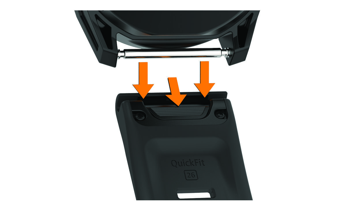

Changing the QuickFit Bands Slide the latch on the QuickFit band, and remove the band from the watch. Align the new band with the watch. Press the band into place.NOTE: Make sure the band is secure. The latch should close over the watch pin. Repeat steps 1 through 3 to change the other band. HomeDevice MaintenanceChanging the QuickFit Bands
