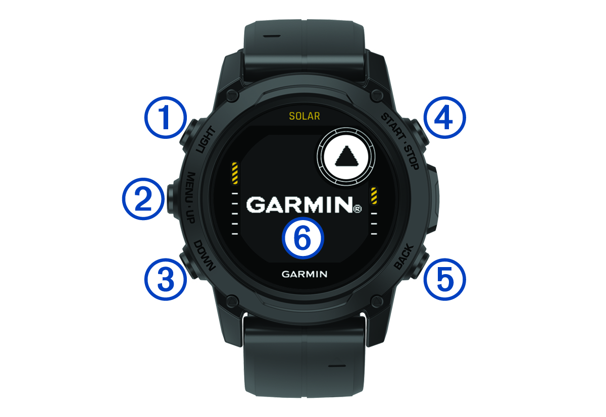

Device Overview
LIGHT
  • Press to turn the backlight on and off.
  • Press to turn the device on.
  • Hold to view the controls menu.
NOTE: While diving, hold functions are disabled.
MENU·UP
  • Press to scroll through the glance loop and menus.
  • Hold to view the menu.
NOTE: You can enable or disable this button for dive activities (Dive Setup).
DOWN
  • Press to scroll through the data screens during a dive.
  • Hold to view the altimeter, barometer, and compass (ABC) screen.
START·STOP
  • Press to view the activity list and start or stop an activity.
  • Press to choose an option in a menu.
  • Press to view the menu during a dive.
  • Hold to view the clock menu.
BACK
  • Press to return to the previous screen.
  • Press to exit a menu during a dive.
  • Press to record a lap, rest, or transition during a multisport activity.
  • Hold to view the watch face from any screen.
  • Hold to return to the primary data screen during a dive.
: Double tap the device to scroll through the data screens during a dive.
