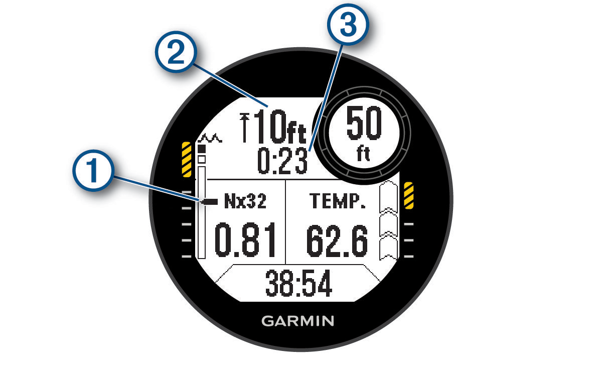

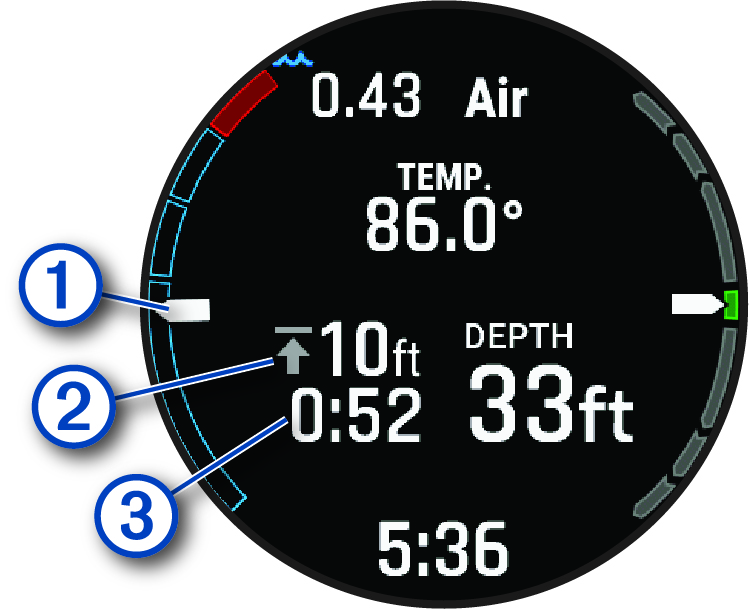

  1. When you exceed the no-decompression limit (NDL) time, begin your ascent. Decompression stop information appears on the data screens.
    Your depth relative to the surface.
    As you ascend, your position moves upward toward the required decompression stop depth. The empty segments represent cleared stops. You may clear a stop before ascending to it.
    The decompression stop ceiling depth.
    The decompression stop timer.
  2. Stay within 0.6 m (2 ft.) of the decompression stop ceiling depth until the decompression stop timer reaches zero.
    NOTE: If you ascend more than 0.6 m (2 ft.) above the decompression stop ceiling depth, the decompression stop timer pauses, and the device alerts you to descend below the ceiling depth. The depth and ceiling depth flash red until you are within the safe margin.
  3. Continue ascending to the surface or the next decompression stop.
