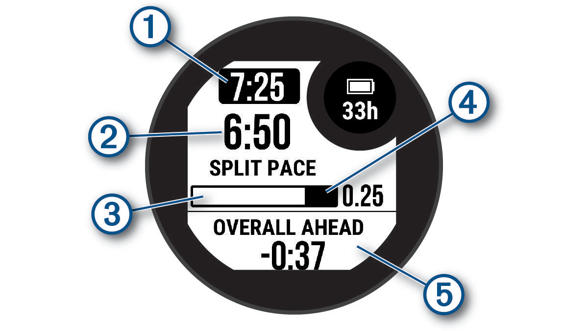

    Target split pace
    Current split pace
    Completion progress for the split
    Distance remaining in the split
    Overall time ahead of or behind your target time
