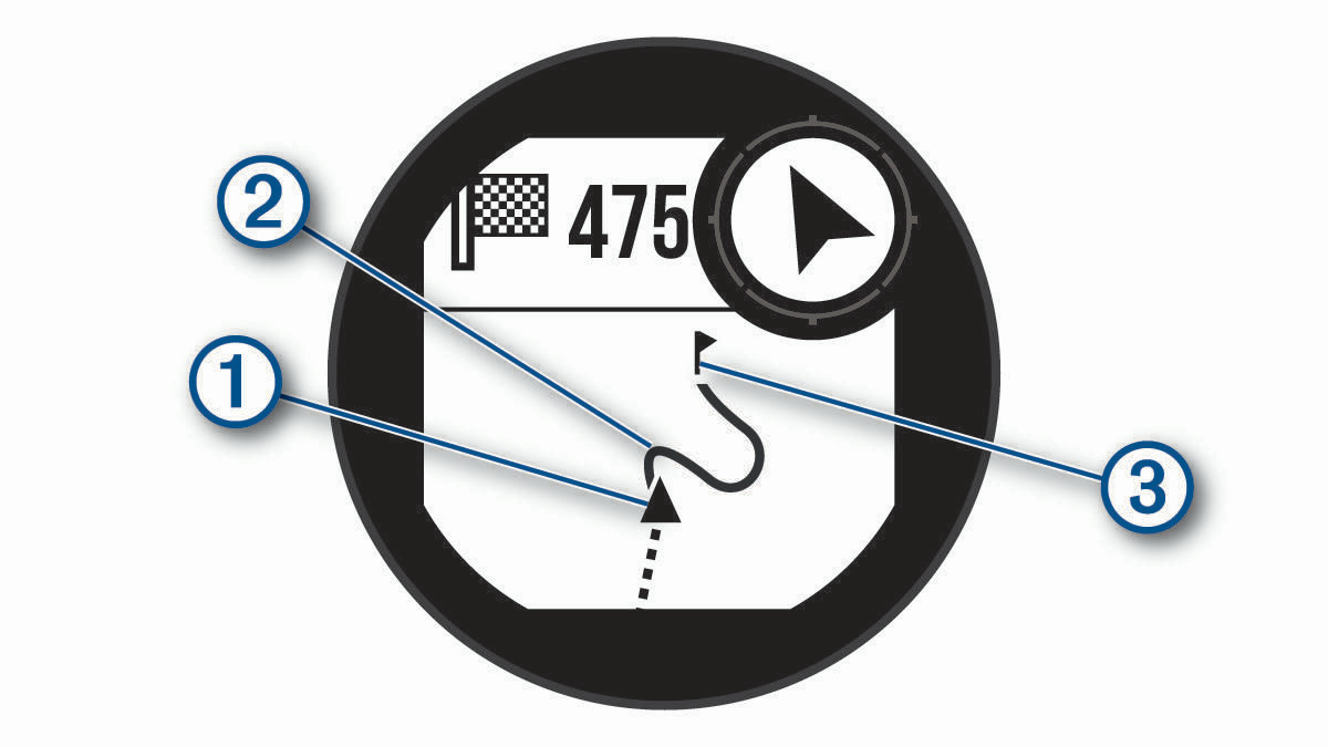

Your current location
, the track to follow
, and your destination
appear on the map.
