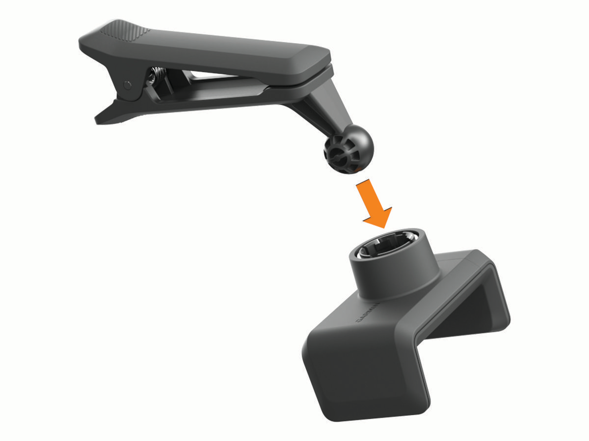

  1. Insert the bag clip ball mount into the back of the phone mount until it clicks into place.

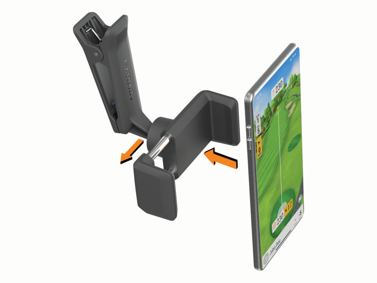

  2. Pull the adjustable side of the phone mount outward.
  3. Position your smartphone within the phone mount.
  4. Release the adjustable side of the phone mount to secure your smartphone in place.

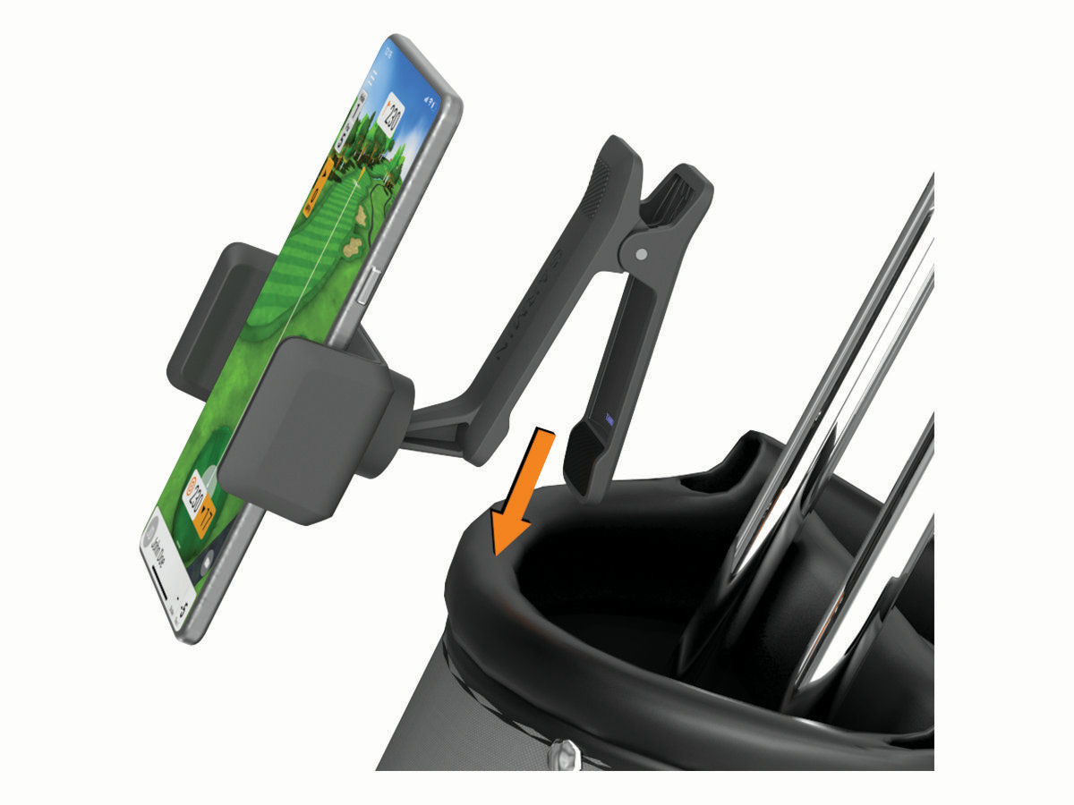

  5. Clip the bag clip to the top of your golf bag.
    NOTE: Your smartphone should sit below the top of the bag to avoid making contact with your golf clubs.
