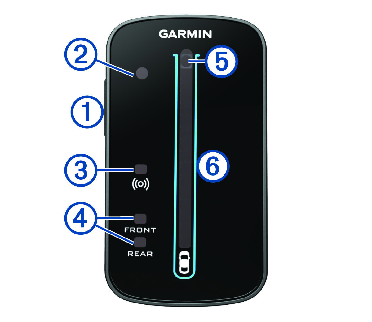

Varia RDU Device Overview
Device with callouts
Callout number one
Device key
Turns the device on and off.
Callout number two
Ambient light sensor
Detects available light and automatically adjusts the brightness of the display.
Callout number three
Connection status LED
Appears solid blue when the device is paired with the radar device. Flashes blue when the device is searching for the radar device.
Callout number four
FRONT and REAR device status LEDs
Flashes red when the battery is low. Appears solid red when there is a device error.
Callout number five
Threat level LED
Charging status LED (Charging the Device)
Changes color based on the potential level of threat. Green indicates no vehicle is detected. Amber indicates a vehicle is approaching. Red indicates a vehicle is advancing at a high rate of speed.
Callout number six
Vehicle position LEDs
Moves up the column as the vehicle gets closer to your bike.
