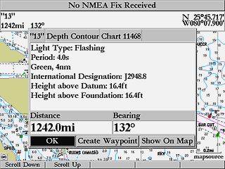

screen exampleBlueChart cartography is "object oriented",meaning that each feature displayed can be associated with additional information. For example, when placing the chartplotter’s cursor on a navigational aid, a window can be displayed with additional information for the selected navigational aid.
screen exampleHere is a good example of what Garmin® means by "Object Oriented". On the picture to the left, you will notice the cursor has navaid #13 highlighted.
screen exampleWhen the feature is highlighted, and the ENTER key is pressed, additional information about the feature is presented, as show in the example to the right.

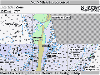

screen exampleBlueChart data is not seamless. Just like the paper charts from which the data is derived, you may observe some discontinuity along chart borders. For example, if a contour is present on one chart, and not on the adjacent chart, the BlueChart data will be represented on your chart-plotter in the same manner. Likewise, if adjacent paper charts used to generate BlueChart data are of different scales, you may encounter shaded areas on the chartplotter’s map screen. This can occur at any zoom level and can be easily remedied by zooming out one or two scale levels.

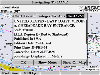

screen exampleTo display paper chart-specific information, place the chartplotter’s cursor on an open area of the chart (absent of any chart features) and press ENTER. A window will appear showing the chart information and allowing you to view any additional notes about the chart area.

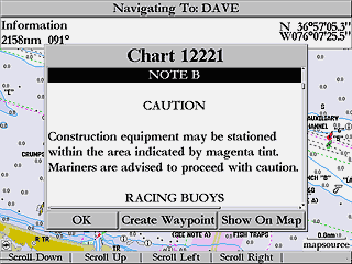

screen exampleEach paper chart contains a header that explains hazards and other important information. These notes are also accessible on the BlueChart cartography. Once the chart info is shown (see above), simply select "Show Notes".

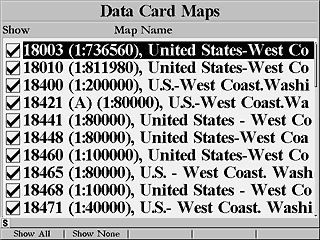

screen exampleA feature of presenting data in a chart-by-chart manner is selecting only those paper charts that you have on hand or that you want displayed on the chart-plotter. By default, all available charts will be displayed. See your chartplotter’s owners manual for specific steps, but the screen will generally appear as shown at left. From this screen, use the chartplotter’s on-screen cursor and ENTER key to deselect (remove the check mark from the box) the individual paper charts you do not wish to display.
